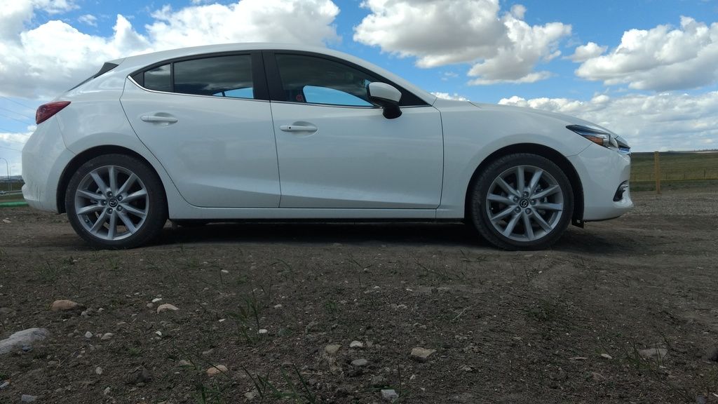

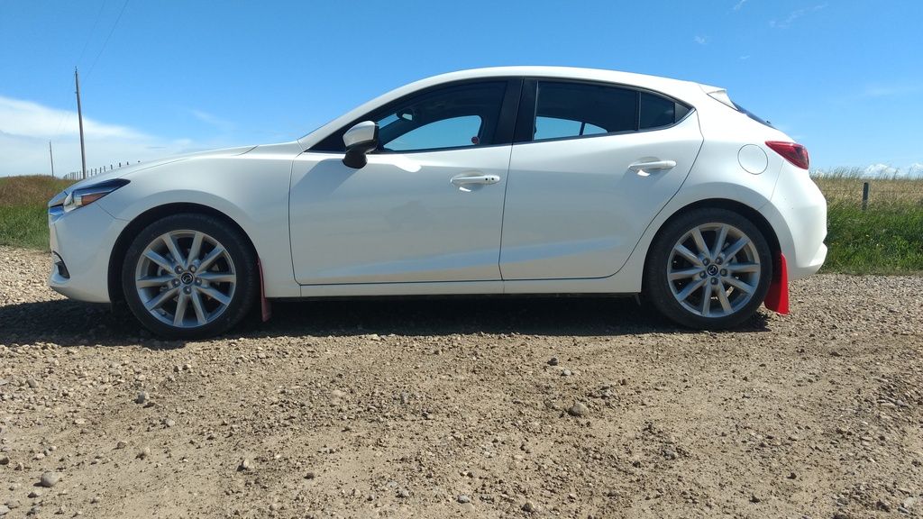

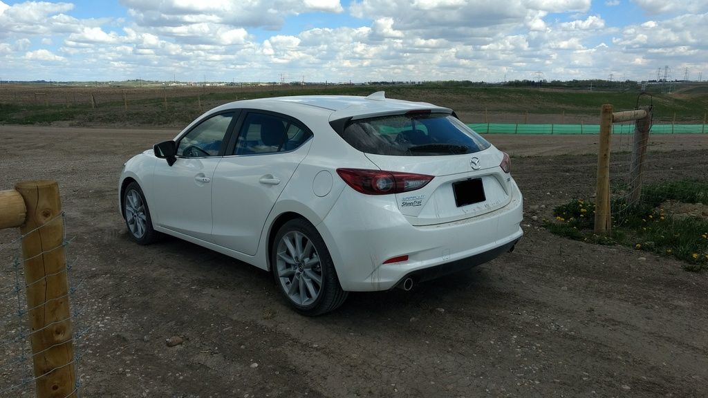

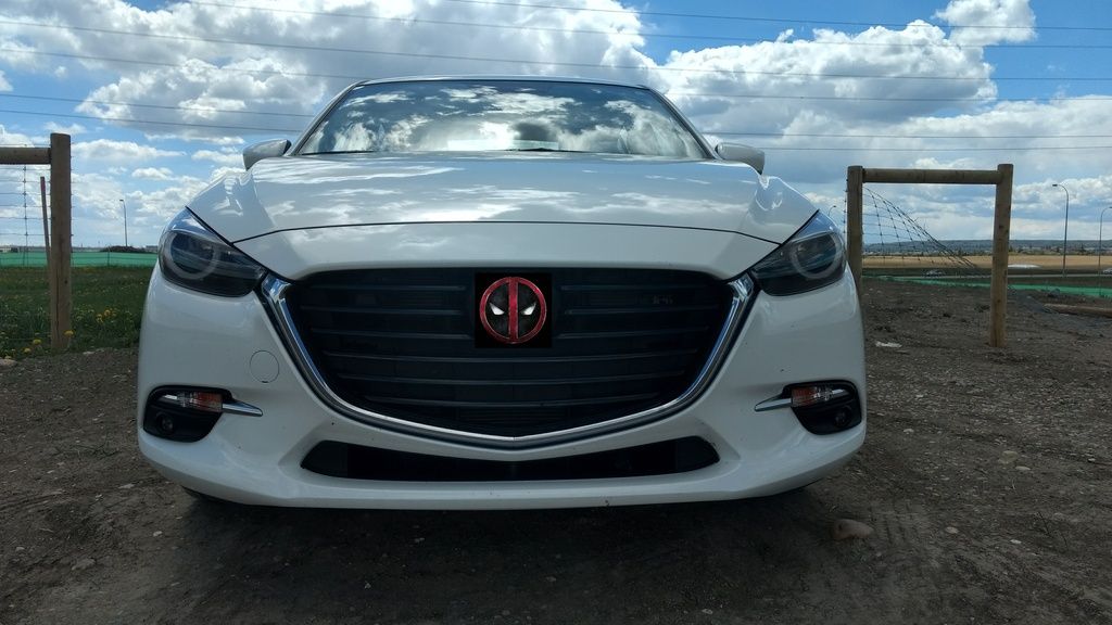

Finally took some more pictures, also added my first three mods. Yes, I know its dirty, and yes, I will be washing it again soon lol.
Mod #1
-Green M&M
Mod #2

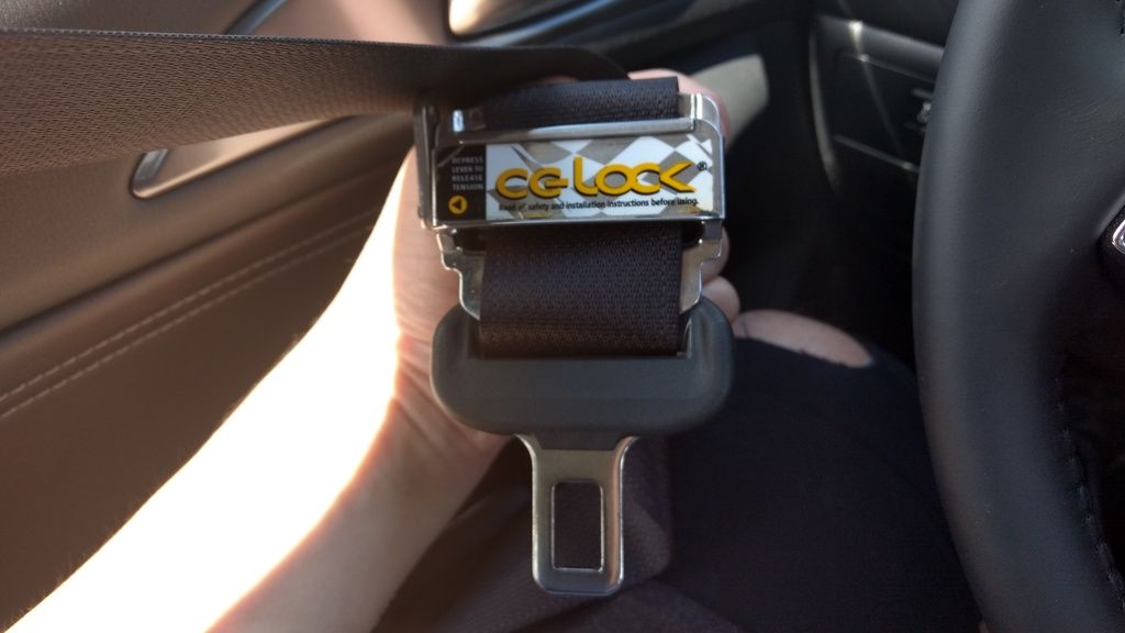

-CG Lock
Mod #3
-Corwin9's MZD Deadpool Theme

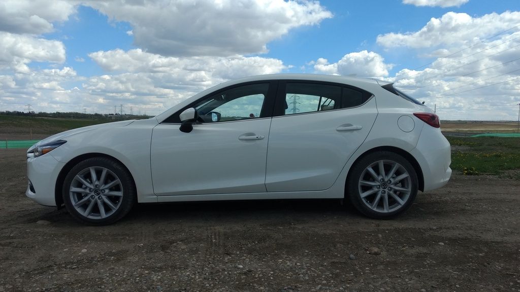

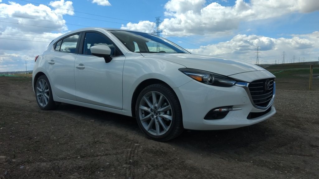

New Exterior Pics
Upcoming Mods
Here is a taste of what's to come

FYI, if you are going to take off all the rear emblems, be prepared to have holes that you will have to deal with. Atleast on the 2014-2016 there are holes under the "MAZDA" and the "M" on the hatchback. You can safely remove the skyactive and the "3" though.
*The Electrician*
1,010 Posts
Discussion Starter · #9 ·
Yup I have been warned of that already, lol a few times actually. I have not decided if I will debadge yet, but if I do I will make sure the holes are filled properly.

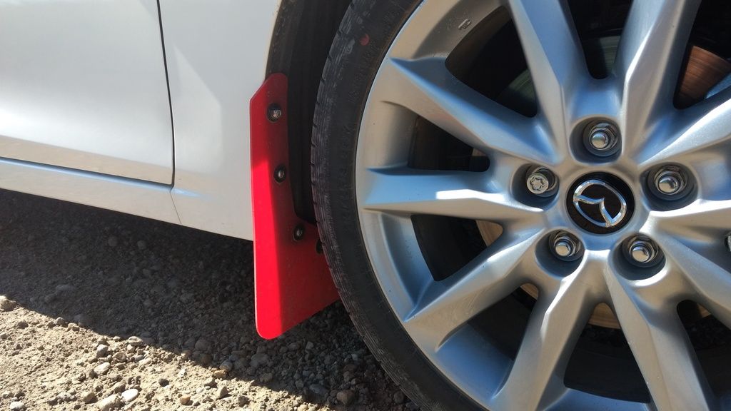

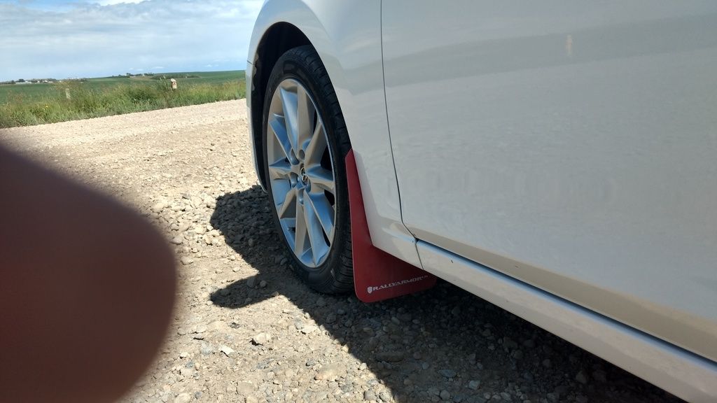

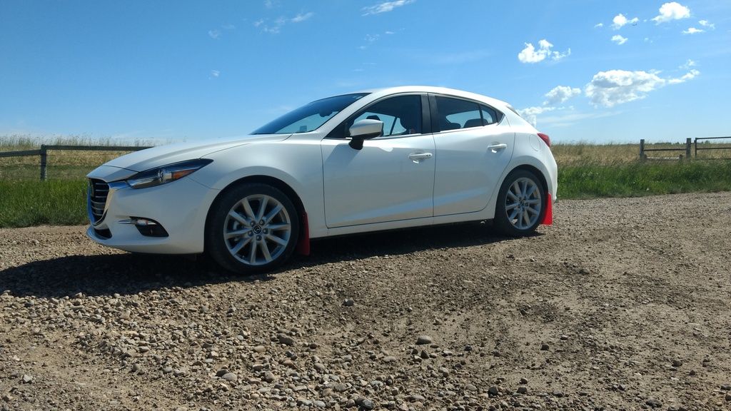

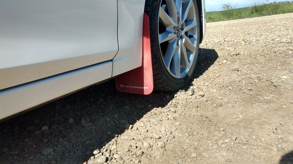

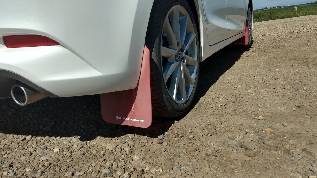

Finally making some progress on my build, got my Rally Armor mudflaps installed, ordered my MX5 ND Miata shift knob, and had my first oil change already lol. I will post some new pictures in a couple hours. Next up is exhaust, should have it done hopefully in 2 weeks and will post pics and videos.
The rally armor mudflaps were a fun little project, the fronts came together really simple and easy. The rears everyone says remove the rear wheels but it just isn't necessary if you have the right tools. Things I used to help me, a deep socket 14mm for the cap/nut at the back of the rear wheel well, a small ratchet with 8mm socket and phillips bit, a small flathead screw driver for the pop-clips, and my super long arms lol. For the rears there was 2 holes to drill in the plastic, using the method of marking it from the rear while it was still attached after removing both bottom screws to accommodate the marking process was definitely the best option. I used a 1/8th drill bit for a pilot hole and then my 1/4inch to open it up. All in all I am very happy with the looks of them and will definitely be having these on all of my future cars.

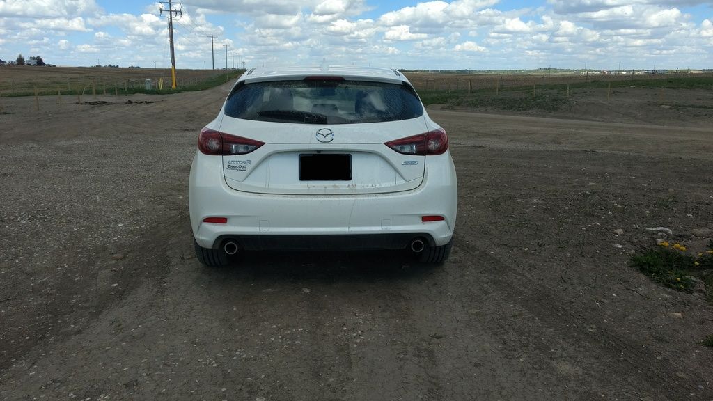

Exhaust is now complete, replaced oem muffler with a vibrant resonator, single exit, random used tip, very deep tone, not too loud at all. Minimal drone and its baritone sounding so not like that nasty rice drone that sucks and sounds like ass. Very pleased with the results, all told I spent under $250 for this setup. I would definitely do it again.

Build looks good man, did you DIY the mud flaps or buy the car specific kit? Looks like you did the kit, but I just bought the DIY version and was wondering if you had any pointers if you went that route.
It's a rally armor kit, very straightforward install, i advise removal of rear wheels, less hassle ?
