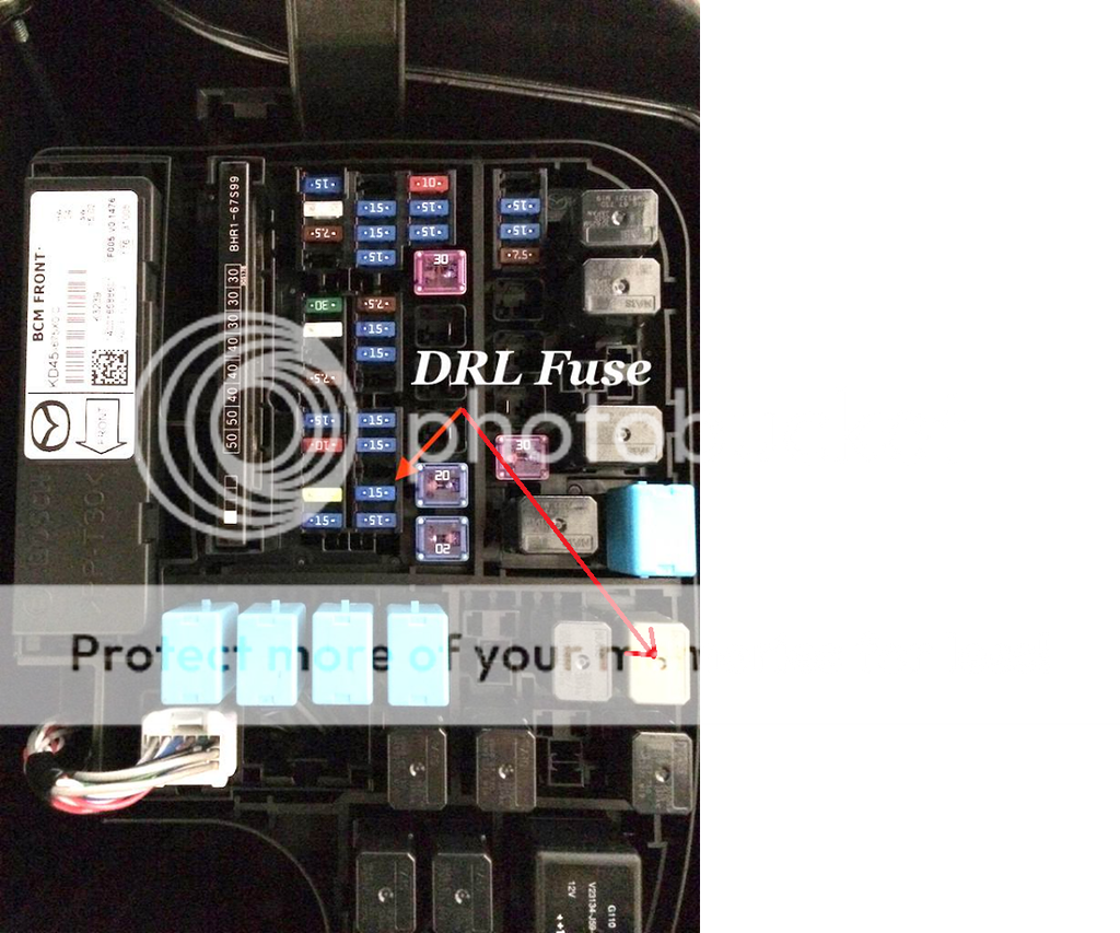

So I wanted to disconnect my halogen DRL.
There two options (a 15amp small piece - top left, and a box/square fuse - bottom right)
Whats the difference between pulling one fuse over the other?
I saw in another thread they disconnected the top left fuse to disable DRL. However i pulled the bottom right and achieved the same thing. Does it matter? Thanks!

2 fuses you could pull:
MAP for reference:

The car in that link is a Gen 2 car. You would have to check the fuse map of the Gen 3 vs the older cars to see what is where. Bottom line, do it and see what happens.

Don't disconnect the fuse
There's an actual built in method to turn it off (what the dealer would do)
someone on the forum provided the steps on how to do it
http://mazda3revolution.com/forums/2014-2016-mazda-3-skyactiv-how-guides/61129-disable-drl-daytime-running-lights.html
worked for me, I disabled them this way and I'm only running my LED fog light covers as DRL's
I've even disconnected the battery a few times and it still retained the setting so it's like hard coded in
I tried that twice on my 2016. It didn't work.
62 Posts
The larger one of the two is a relay. If I were to choose between the two, I would go with the relay. My guess is that this should prevent any current from going to the fuse.

56 Posts
Disconnecting either works. I just didn't know what the difference was or if theres a preferred method
789 Posts
I pulled the little fuse and the DRL went away. It just seems so simple to do compared with the complicated turn-off process, which did not work for everyone.
I kept the removed DRL fuse as a spare in case it's needed for another purpose in the future.
