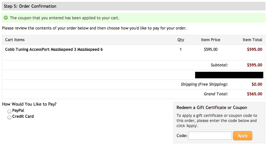

Its been a long road to take the leap but i decided that you dont just get a MS3, you must always get a Cobb Ap and thats what i did.
I cant wait for it to get home, now im on the road for that engine performance.
Next step i already know its Autotech internals, from there i wanna eventually get Cobb Intake and TIH / TIP, but well have to wait a bit for that.

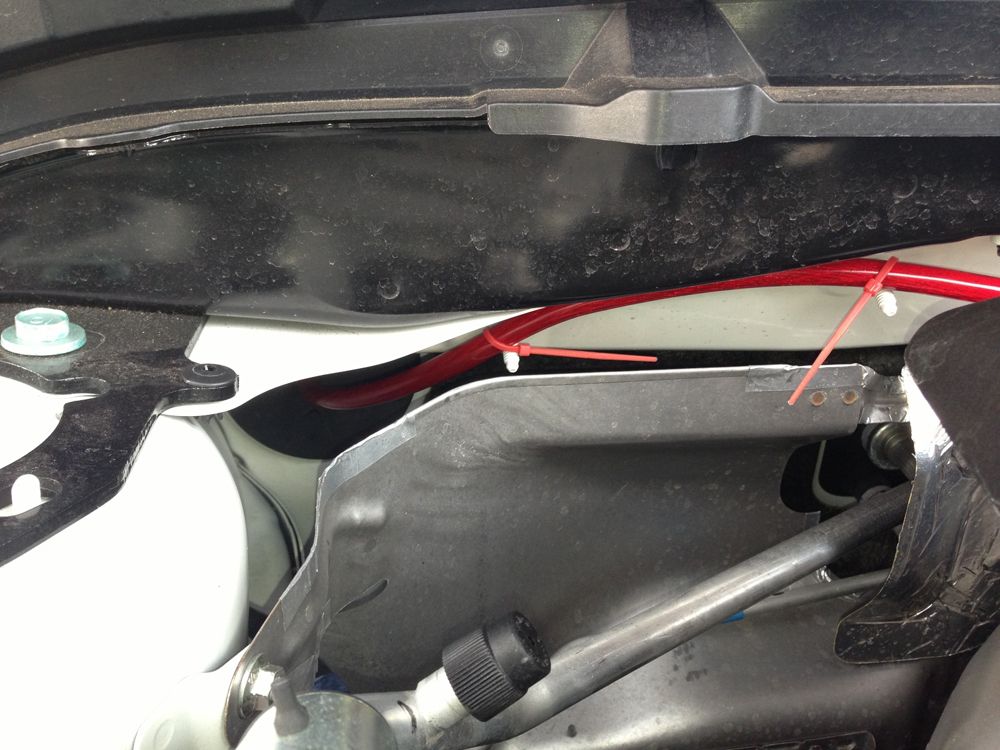

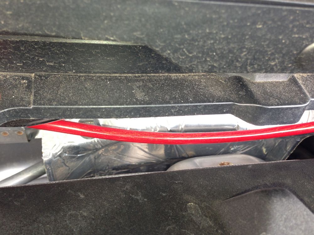

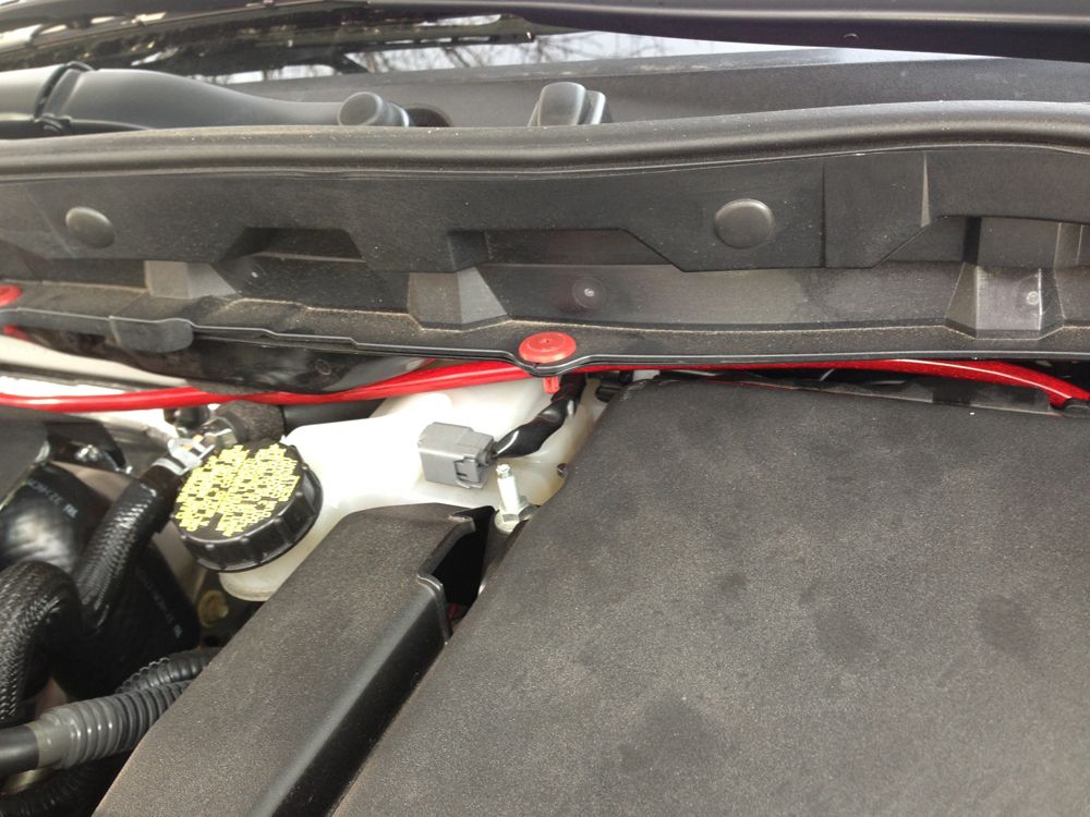

Battery wire routed through the plastic grommet behind the glove compartment, (btw couldn't add one of the goldplated terminals to the battery cause i couldn't crimp it together to the wire. I didn't know exactly how hard those stupid things are to bend. So i made do.
Had to bend that piece of metal that protects the firewall while i did the routing and then bolt it back together.

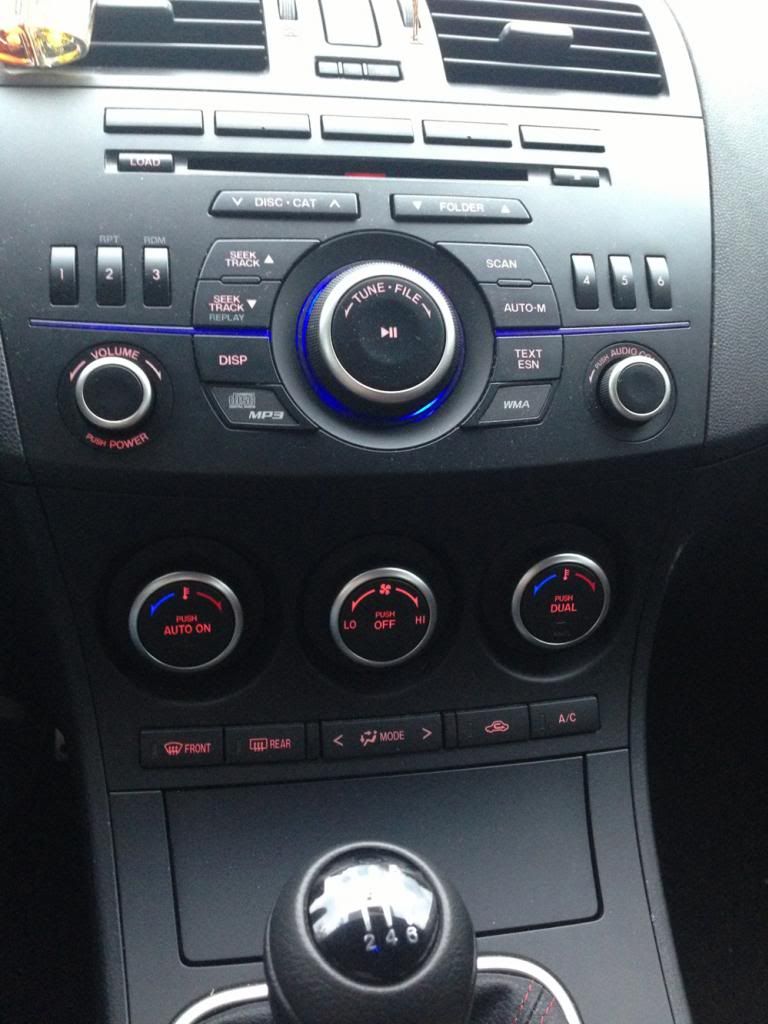

Bose Head Unit Before.....
Head Unit After....

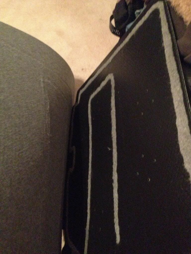

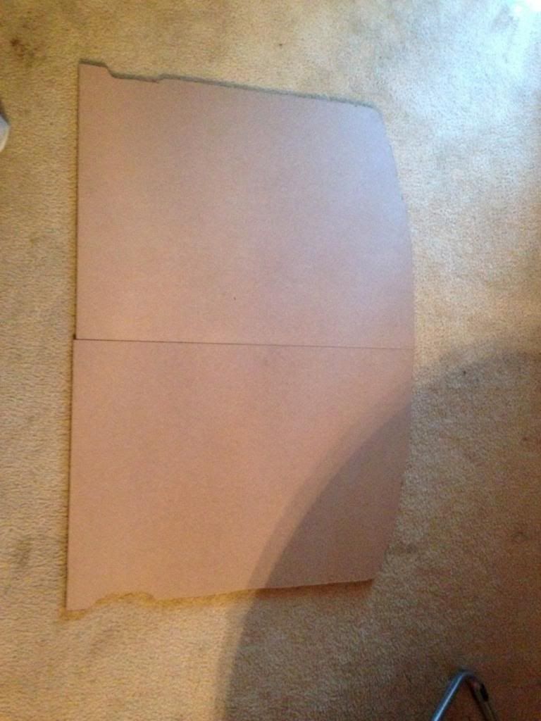

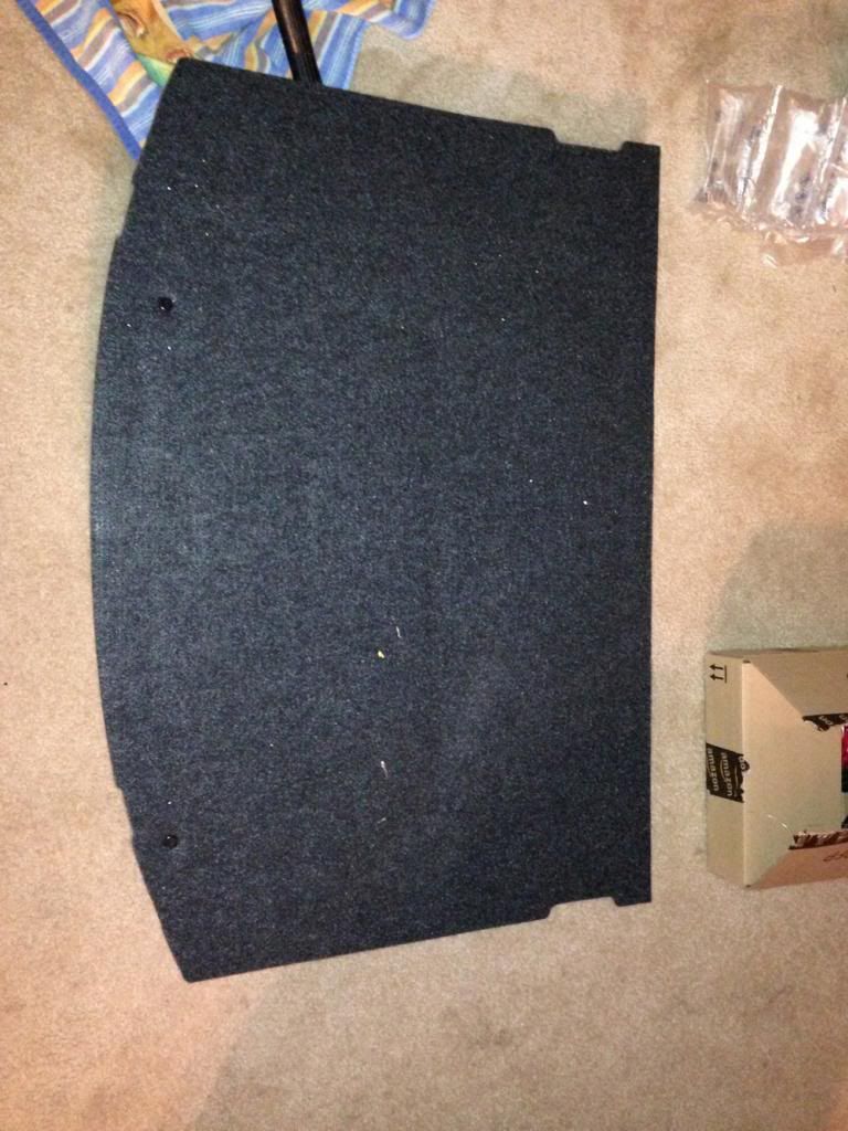

Since it was so cold i started to make the trunk base for the subwoofer, i wanted it to be strong so i can drill the box down but still have a quick release. Much research was done on this, and most people lock them down for good, but i like having a hatch for that reason.
I took the carpet flooring out of the trunk.
Used it to trace the shape onto the pieces of MDF 1/2" and cut it. Then used 4 joiners for the two pieces of wood, two on one side, two on the other, i didn't take a pic of that tho.
Then separated the plastic between the carpet and the bottom styrofoam
Not as easy as it looks, took me about a half hour while watching tv and a razor blade so i dont cut my fingers off. No fake nails on for this one.
Glued the styrofoam plastic thing to the bottom of the wood, and the carpet to the top of the wood. Got a handle for like a drawer at home depot and drilled it onto the board so it was easy to access the spare tire and all the stuff there incase cause the wood turned out to be a snug fit. All in all, came out decent.

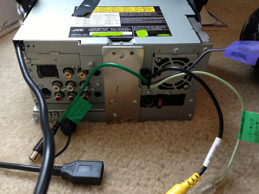

The HeadUnit
JVC avx840 with the bezel from ebay. It came with the antenna adapter which happens to be a honda part lol. PS. the blue wire that comes with the antenna if you plug it into a +12v switched power from the stereo it gives it a boost and i get better reception.
The Back of it

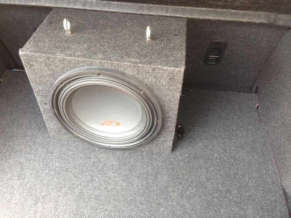

The Sub, 12" Alpine 1243D in a sealed Box, PreBuilt yeah yeah, i should build my own but for the time being the pre fabricated one is doing well. Although Ported is the way to go in my opinion.

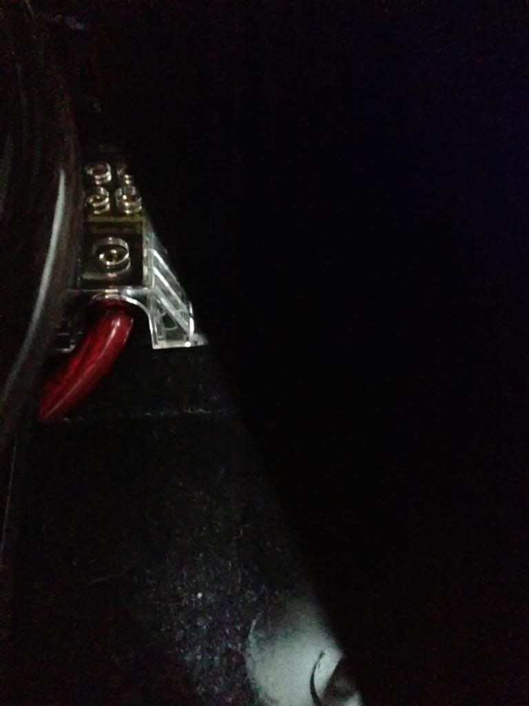

"Battery wire routed through the plastic grommet behind the glove compartment, (btw couldn't add one of the goldplated terminals to the battery cause i couldn't crimp it together to the wire. I didn't know exactly how hard those stupid things are to bend. So i made do".
Nice build but that positive battery terminal need to be revisited. Since that amp wire is in the car already you need a big strapping dude to crimp a ring terminal on the end of that amp wire.
100 Posts
well done. didn't notice any "broken rules" for an audio install. the fuse for power was within 16" of the terminal, kept your ground points within 12" of the amps, and kept your RCA's away from the factory wiring and power wire. looks like you know what your doing. might I suggest using wire loom and black zip ties on any exposed wires. would be the finishing touch to a professional install. were you going to tackle the alarm yourself? might as well do a remote start/alarm combo unit. many of the wires you tap on to for an alarm, you need for a remote starter. there are units that do stick shift also, which I would recommend (much safer). looks like a remote start would be nice to have being in NYC and under two feet of snow.
I'm no expert but the amp lead to the pos terminal doesn't look kosher and actually might be a problem at a later date. If I'm wrong then carry on as if I never existed. :yes:
your right lord, she'll need the industrial crimp tool to add the terminal. the thing is as large as a bolt cutter. well, it pretty much is, but crimps instead of cuts. not an off the shelf tool you'll find at HD or Lowe's.

Yeah I was going to say you might want to fix that wire on the positive terminal and get it crimped the right way on one of the gold o-ring you have. I use a giant lock jaw pliers and mushed it down when I set mine up and it crimped it good.

As for that positive terminal i agree Warlord, i actually still have the terminal but those things are amazingly hard, i mean i got it bent like a millimeter lol Sooooo, im actually gonna have one of my friends use a crimp tool to secure it nicely. Yeah those gold plated 4 gauge rings are insanely hard, i'll post a pic of the revisit once its done :tongue: Also the wire loom, its a must Thank you for the tip i didn't even think about that but it would add a nice touch.

On that large battery connector... I have found a secrete to use a large flat head or duel chisel with a small sledge mallet on a vise works also :)

thank u ;) i actually wasn't sure how to do this right and those crimp terminals were the death of me lol. So i had my friend do it for me. Sound was the same but at the end of the day i had more peace of mind knowing it was properly wired.

Hey Summer you have done some good work getting your Mazda rocket how you want it. But here is your answer to your amp lead connector problem :001_cool 1:. Just put shrink sleeve on the wire first. Crimp the connector on the wire and then slide the shrink sleeve over the crimped part of the connector. And it will look professional.
