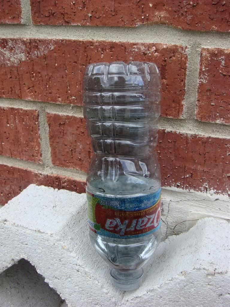

ok so night shade is rather dark. so i was out shopping for something else, i was originally looking for duplicolor, metal cast "smoke" which is their metal cast /anodized line of paint. part number dup-mc206
instead i found rustolium tint. and i bought it and took it home to run it threw some tests....

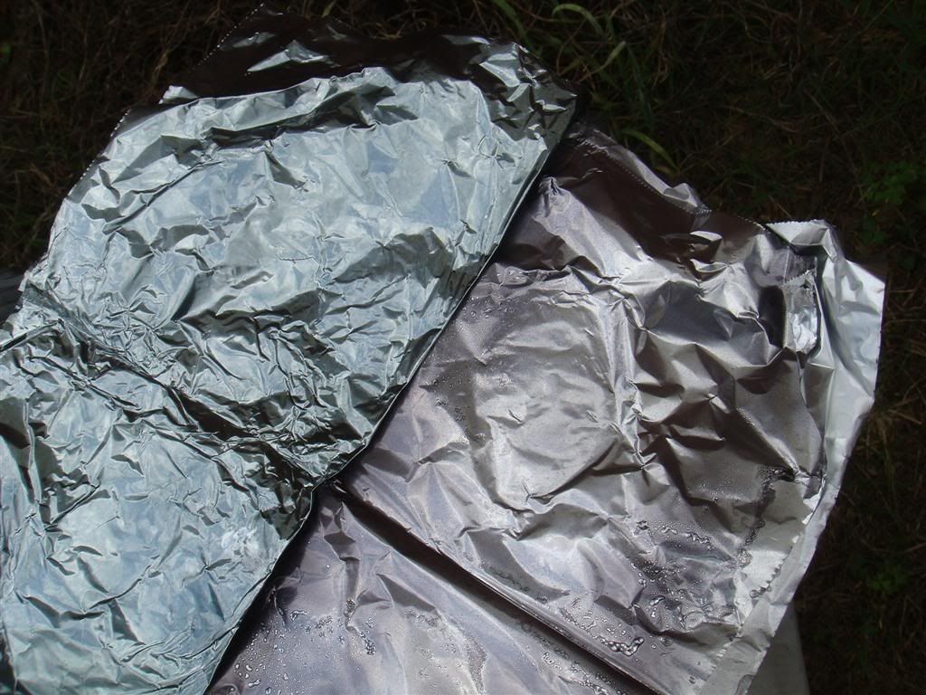

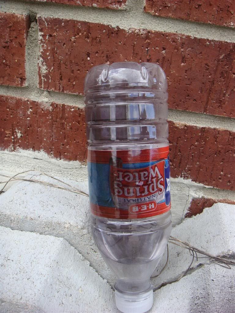

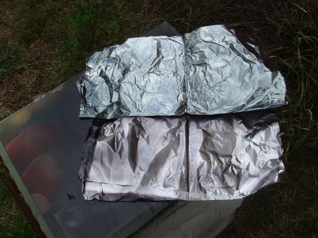

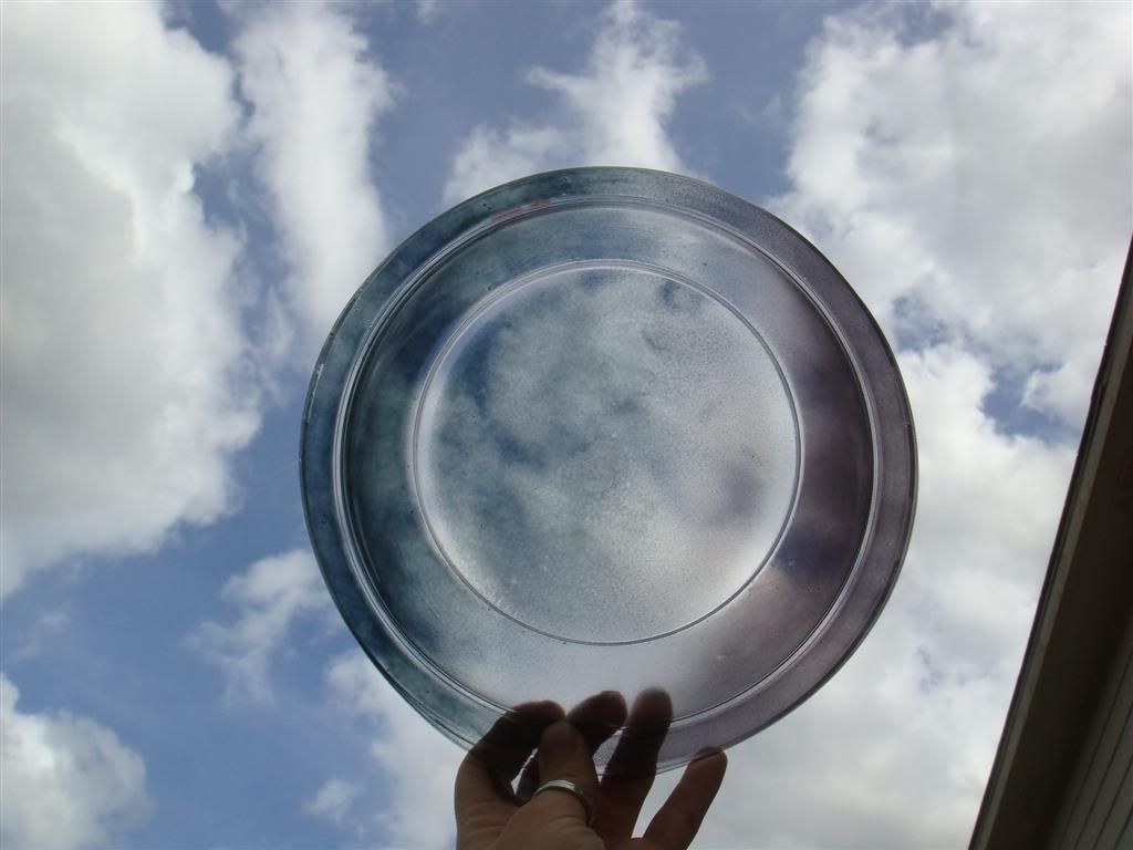

i tested it on plastic and i tested it on foil. i will be painting the reflective areas inside my headlight lenses similar to what darkspeed3 did to his. only i want the high beam area reflective still. naturaly i needed to use transparent paint, and i needed one that will react well with reflective surfaces, hence why i tested it on foil...
i did a few tests on water bottles, fast food container lids, and foil...
in each picture, the night shade paint is the one that looks more blue... the rustolium is the one that looks more neutral gray.
nightshadeV
rustolium V
night shade on left, rustolium on right. (rustolium is far less transparent, and very cloudy)
night shade on left, rustolium on right. night shade lets far more reflective properties shine threw
notice you can see the clouds above and the blue from the sky... but you cant on the rustolium side.
rustolium doesnt allow as much to pass threw on reflective surfaces...
my findings. though night shade has a less even spray, it is far more superior in the quality of paint. it is far more transparent. rustolium sprays on way more even with its better nozzle but the paint is so cloudy it detracts from clear surfaces.
