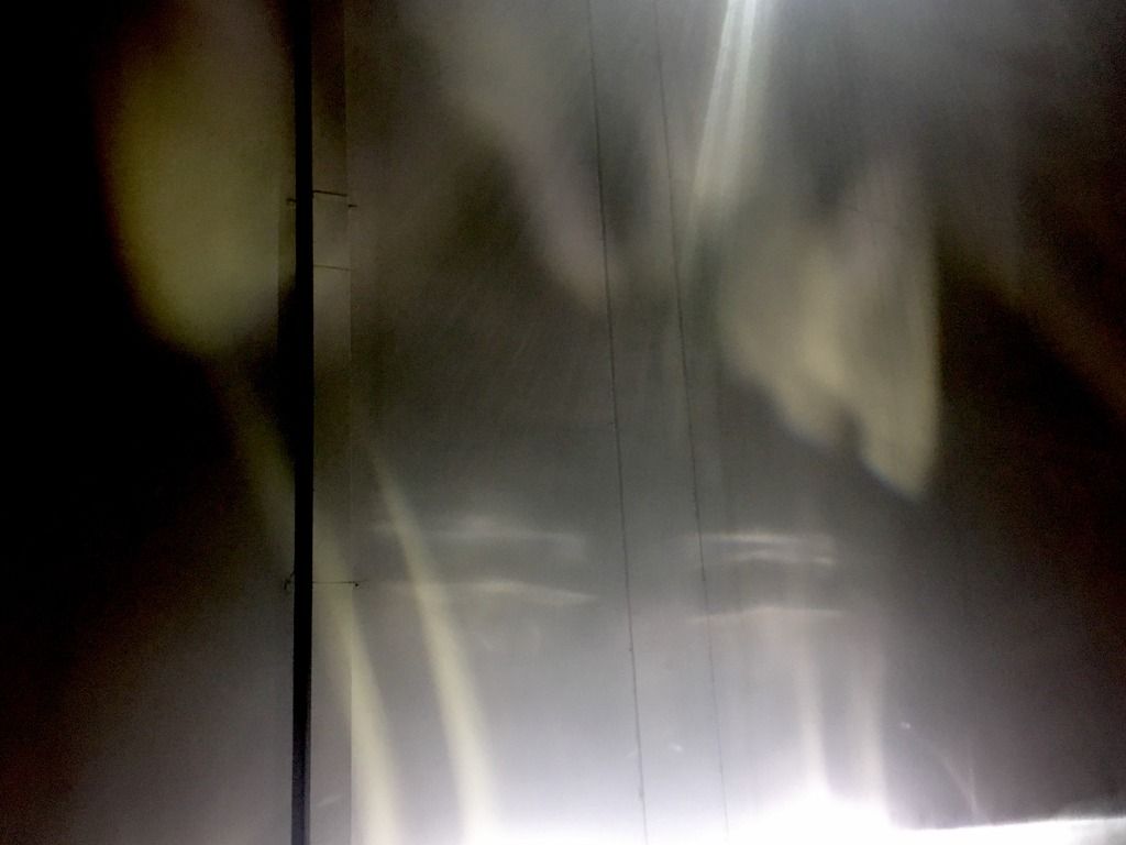

Morimoto is a well known name in the HID retrofitting industry and their projectors are generally really nice units. Having read the glowing reviews of this particular fog light retrofit for our cars, I was optimistic about the resultant upgrade in visibility. There are heaps of pictures of other vehicles with these "XB" fogs online showing crisp cutoff lines and wide throws of light.
I'm wondering if these are the right projectors or are the ones other reviewers were raving about. There is a huge amount of glare projecting upwards, narrow beam pattern, and a very hazy and indistinct cutoff line. For the record, the glare isn't a result of the chrome bezels on the fog light trim or the orientation of the housing; I've got a full range of adjustment up and down.
It does a good job of throwing light downrange and it matches the Osram CBIs I have installed, but it's just not what I was expecting based upon the reviews and images I browsed when making a purchase decision. It would also be nice if the cover was glass instead of a plastic composite. Not sure this is worth the cost.
This glare is upwards of 30' in height - awful considering the car was only 6' away from this building.
This is as low as these can be adjusted in our housings, having removed the extra material in the adjustment bolt's channel. At 20'+. the fog pattern sits about 6" above the HID's cutoff line.
