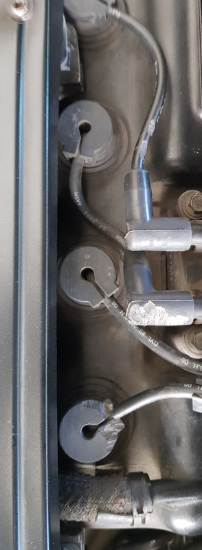

its 36,000km. note that I ride with AC 99% of the time and as stated, on AC it does not vibrate or whatsoever. given that rat visited my engine bay and that now its winter and no need to AC, its only now that I've remarked this and thus a bit worried. maybe its normal when there no "I-Stop, no AC and not on neutral" to vibrate a little but still need to confirm with other Mazda 3 3rd gen owner.

No codes/CEL? You mentioned rat....check your plug wires for scars & test each w/ a multimeter or ground wire or this method: https://youtu.be/x-U9WqJfaJs
The slightest spark leak can trigger vibrations & misfires. My other car was a victim....Look at the bite marks.
If nothing found, try cleaning the throttle body.

Do it by elimination. Spark Voltage leaks can vary & be random depending on load & how bad the leaks are. Anyway, there will be no harm in checking those & the throttle body.
