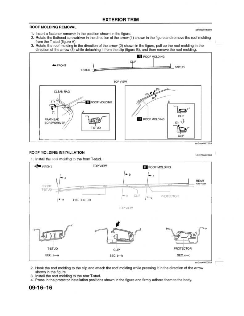

Here are the instructions for the roof molding:
I placed the screw driver, on a rag, under the molding and rotated clockwise. The end popped up with no effort:
Once the end is off, you follow along the molding and then rotate it left or right at the clip and it will come off the clip. Reverse the order when you reinstall it later.
Here's a close up of the clips holding the molding.

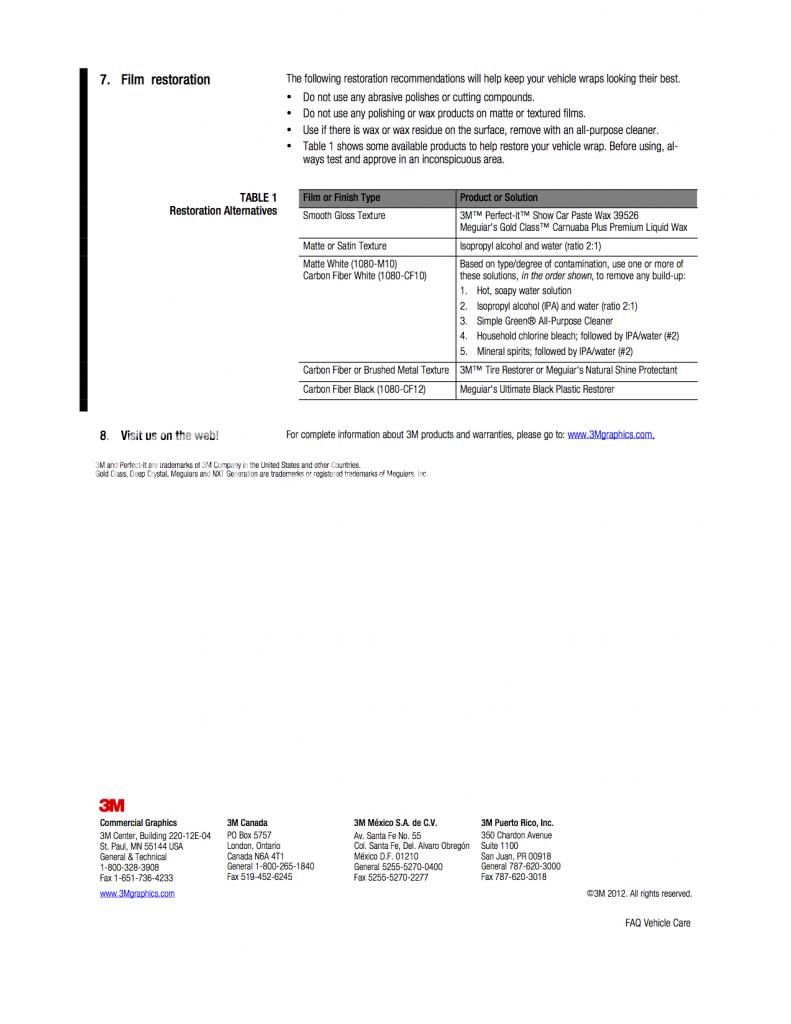

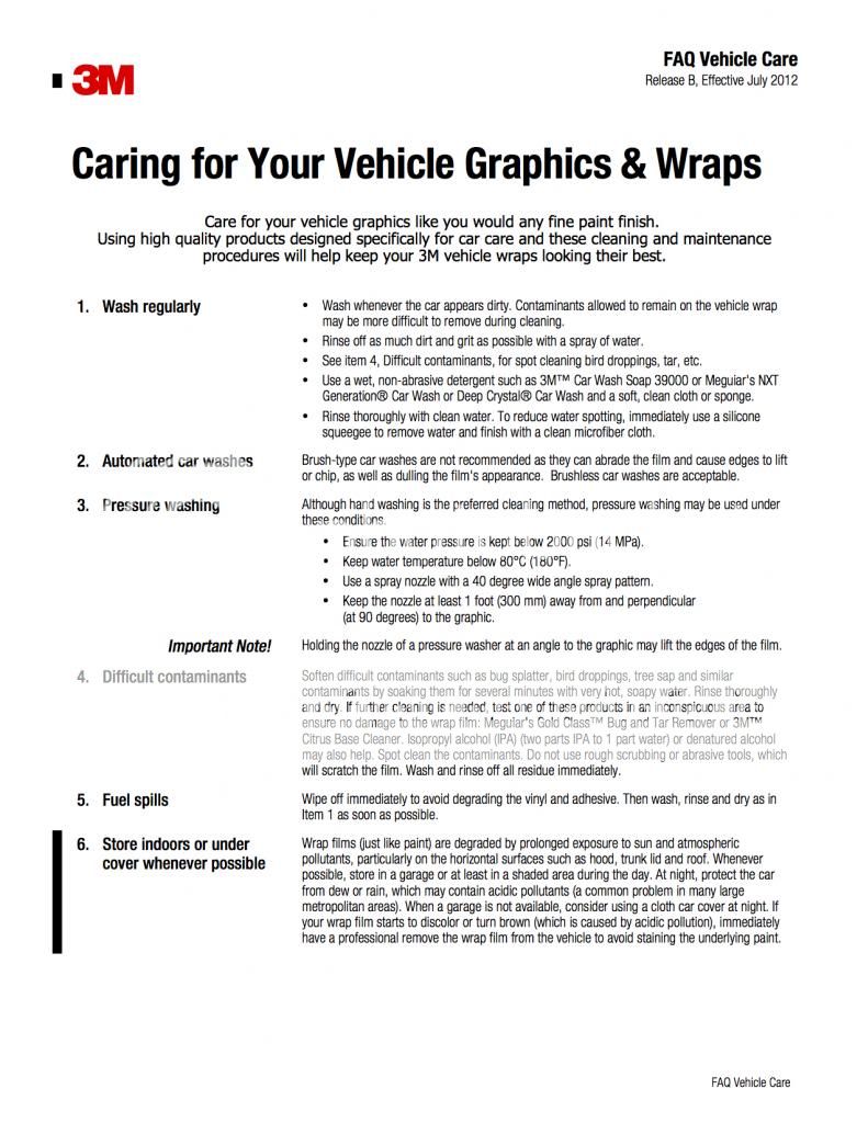

Here's how to care for your wrap from 3M:
Also:
http://www.designerwraps.com.au/how-to/wrap-care/
