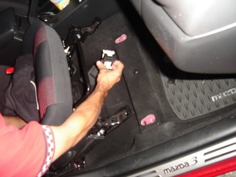

Before you pull the seat up, make sure you unplug the Airbag, plug thats underneath. There is a black lip, that you must squeeze and lift to unplug it. MAKE SURE you DO not have your key in the ignition when doing this or the car with any power on (accesoory mode) It will screw up your side aibag system.
