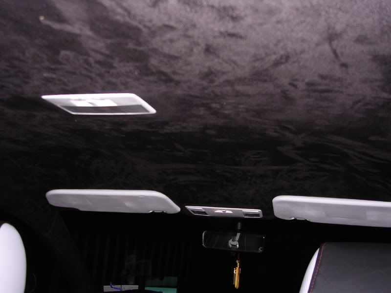

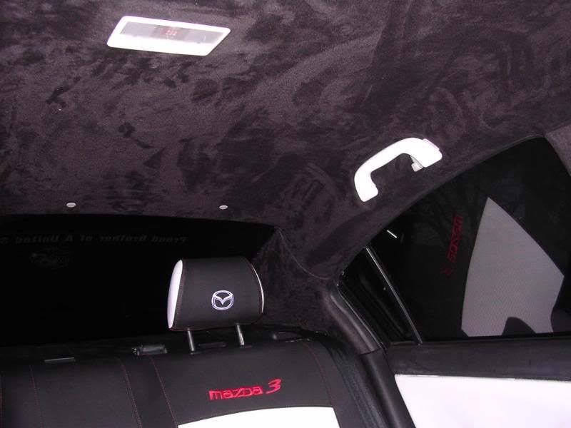

Finished Product !!!

Yeah I'm interested in seeing pics too... The setup looks good now but blacked out visors would really set it off imo.
