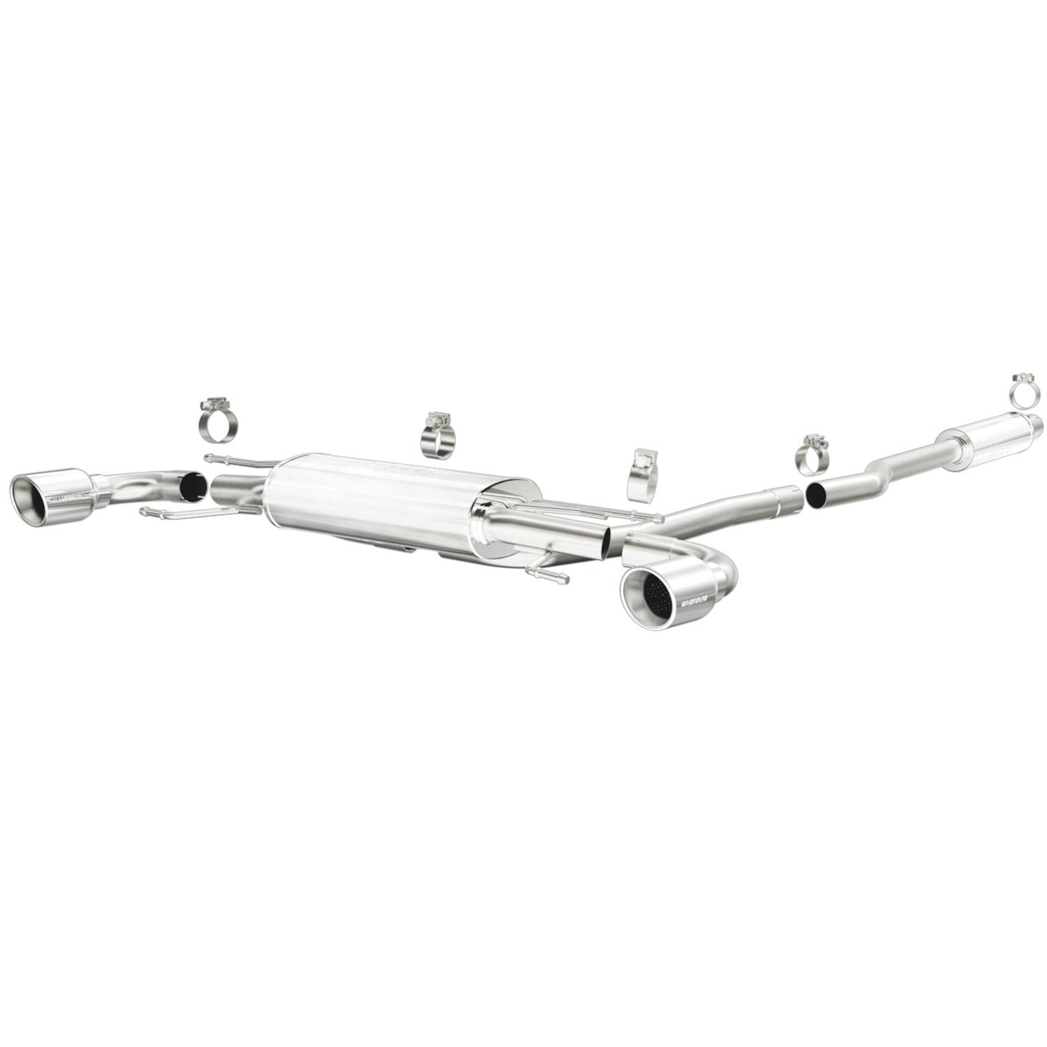

This one better then a cat back exhaust? And think you for helping, I been looking for someone to help me to improve my car, I want to make it more fun to drive
2,855 Posts
Again, Skyactivs won't really gain much from intake & exhaust upgrades...skip the added expense of a catback & just go axleback, if you must....but get OVT if more fun is your aim.
Sent from my SM-G970F using Tapatalk
Super Moderator
5,250 Posts
A proper intake and an axle back will get you maybe 10 or so hp when you do the tune. Depending on your budget, if you are planning on doing the intake or exhaust do it before you do the tune so you don't need to make adjustments later.
