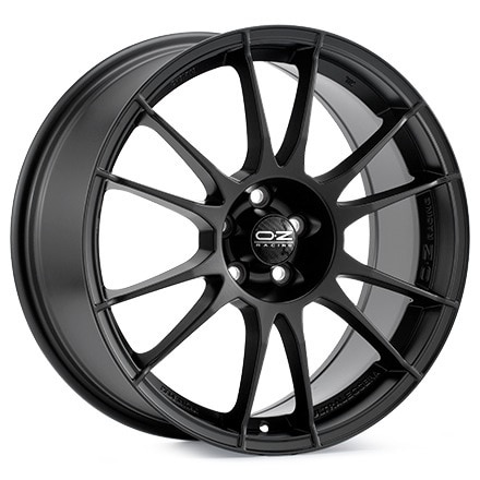

Philosophy behind the choices is strong and lightweight. I am looking for improved performance and comfort with the change. Looks come in last but i do like the look of bigger sidewalls and the oz wheels. I have a white m3 s-touring model for reference.
https://www.tirerack.com/wheels/Whe...h=Black+Painted&showRear=no&packageFlow=false
OZ Ultraleggara black 16x7 45mm offset - 14.7 lbs which isnt the lightest on tirerack but close. From what i know OZ makes some pretty high quality / strong wheels, the Kosei is lighter but the offset tucks it in more and i have read a few stories about them cracking under normal use. The RPF1s im not a fan of the look/ color available.

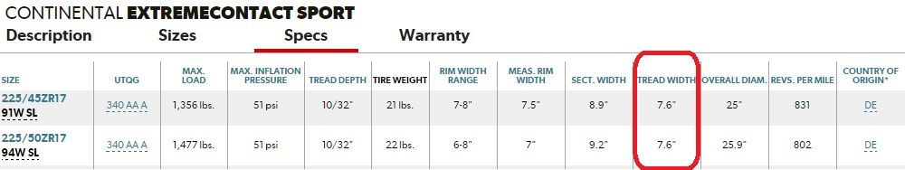

For the sake of curiosity, why not a 225/50? More potential lateral grip correct? Or is the downside to that the requirement of an 8 inch wide rim? Or could you fit a 225 on a 7.5inch rim?

As @arathol says, a 225 will fit, and it will work on a 7.5" rim.
If you haven't already, you can dive into the specs of the tires of interest to you and see how they compare to what you're already running. For example, in the image below you'll see the specs for a pair of 225mm-wide Continental ExtremeContact Sport tires, one with a 45 aspect ratio and one with 50.
Note that the 225/45 has a measured rim width of 7.5" and the 225/50 has one of 7.0" - those are the widths of the rims on which the tires were mounted when the tread and section widths and the overall diameter were measured. What jumps out at me in those specs is that when mounted on those size rims both tires have a tread width of 7.6", virtually identical to the OEM US-spec car's 215/45-18 Dunlops' 7.7" tread width. If you were set on a 225-wide Conti ECS, depending upon what you're trying to achieve you might choose between the two based on one or more of these specs: weight, aspect ratio, or the overall diameter.
The data are from this page: https://www.tirerack.com/tires/tires.jsp?tireMake=Continental&tireModel=ExtremeContact+Sport
If you were to look at another 225mm-width tire, you might find some noticeable variation in one or more of these specs.
