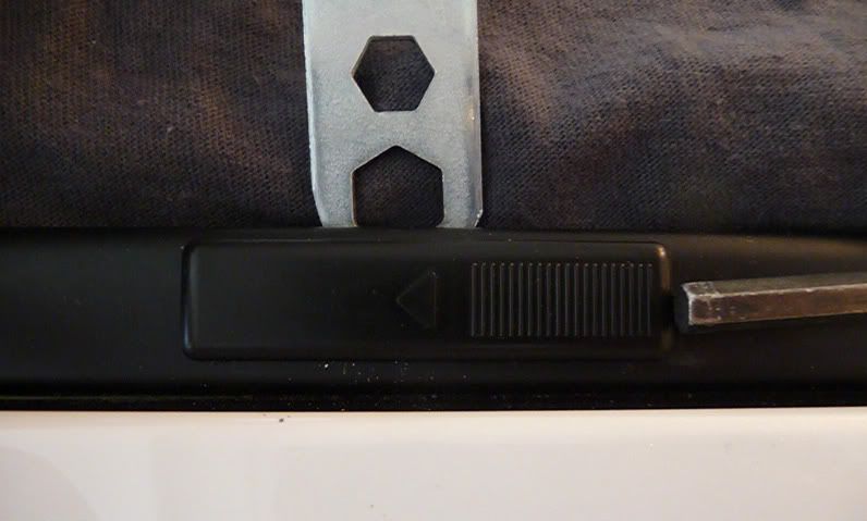

I had a devil of a time removing the little plastic pieces that cover the roof rack mounting screw holes on my 2010 M3 hatchback. I even tried tapping them with a small hammer and chisel to get them to slide, but they wouldn't budge. After completely removing one of the rails, I discovered the problem: the small structures on the bottom of the plastic pieces were pressing directly against the mounting screw holes, i.e. the plastic was obstructed from moving. And the problem was exacerbated by the assumption that I needed to push down on the plastic clips while sliding them.
To get around this issue (which I did on the other rail), I simply lifted up on the rail while sliding the plastic clip. Placing a rag on the roof to protect from scratching, I used a thin object (the Thule rack wrench shown in the picture) to pry the rail upward a few millimeters, then the plastic clip slid without obstruction. After doing this a few times, the rail is now bowed enough that I can slide the clip without having to pry up the rail any more.

I used a flat head wit ha rag on the end.
Put the edge of the flat head on the edge of the cap, give it a tap on the handle from the other hand.
Bam, popped off.

Hi ReD,
Perhaps your rack rails were already bowed upward enough to clear the screw mounts underneath, but what you're describing did NOT work on my car, hence my need to pry the rails upward first. After I got the caps off, I could see that attempting to slide them forcefully had actually damaged some of the plastic structures on the underside of the caps by bashing them into the metal screw mounts.

slid mine right off with my fingers...well not exactly right off..but they came off with just my fingers and a little effort

Mine are a bit tough too, but I use the allen wrench to push it at the edge of the cover and it comes right off. I don't think mine contacts the mounting screw holes though.
