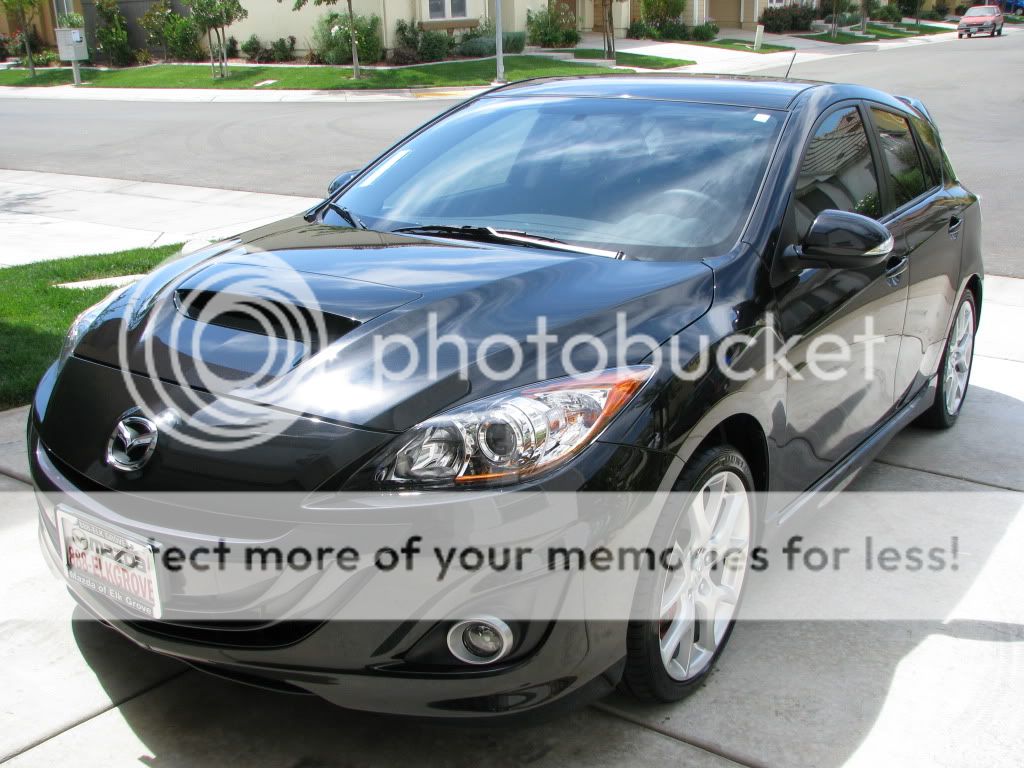

Perhaps you've seen my wife's Mazda3 GT...well here's my own 2010 MazdaSpeed3 in Black Mica.
I've already taken the liberty of painting the brake calipers red and have tinted the windows as well. I've also added an aftermarket security system and upgraded the audio system to something more suited to a vehicle with the Speed's performance capabilities.
