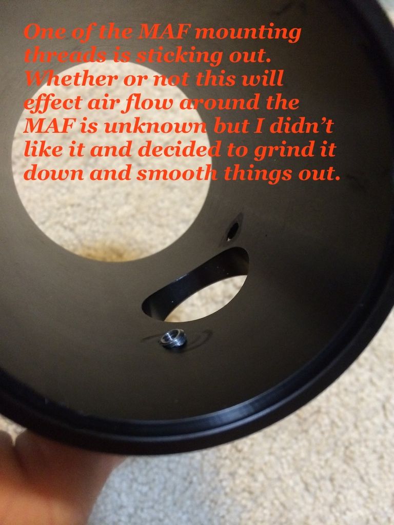

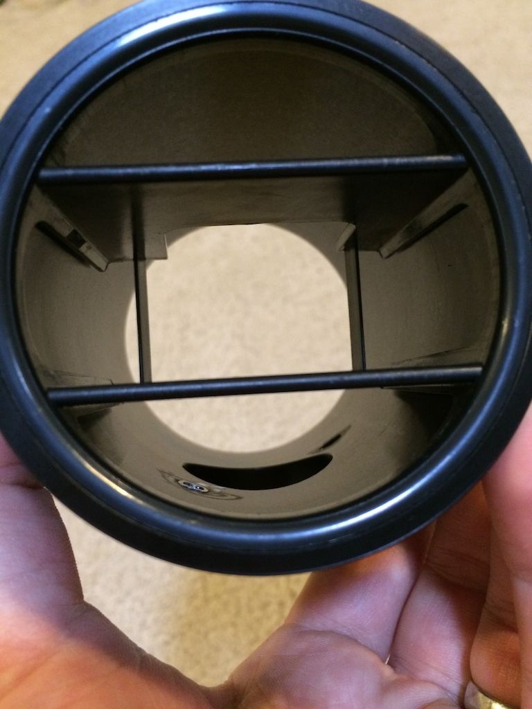

MAF housing imperfections.

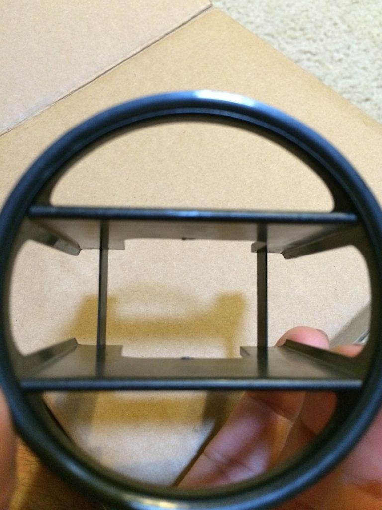

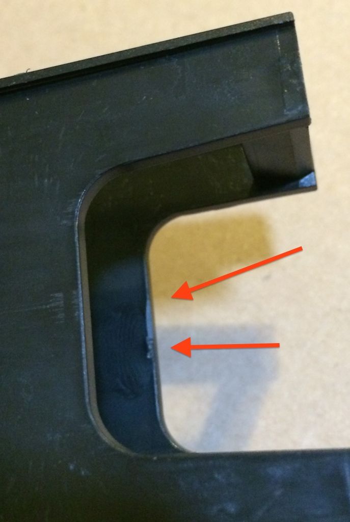

Here you can see some damage to the air flow vanes.
After fixing said issues with a dremel.

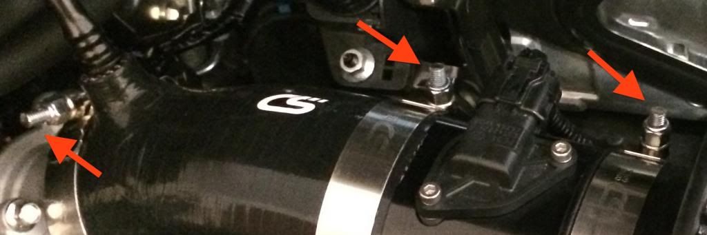

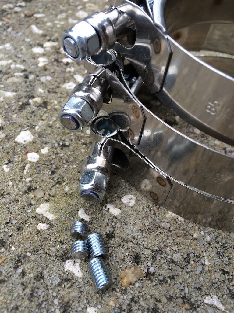

The threads on the clamps seemed WAY too long to me, after everything was tightened down, so I decided to bust out the dremel one more time.
Even after trimming the threads a bit, after I bolted everything in, they are still sticking out a good amount. It's not a big deal but with the threads being so long, my 10mm small socket wasn't deep enough to tighten the clamps with the threads getting in the way, so this had to be done.
This pic shows the final assembly and the amount of thread sticking out AFTER trimming.

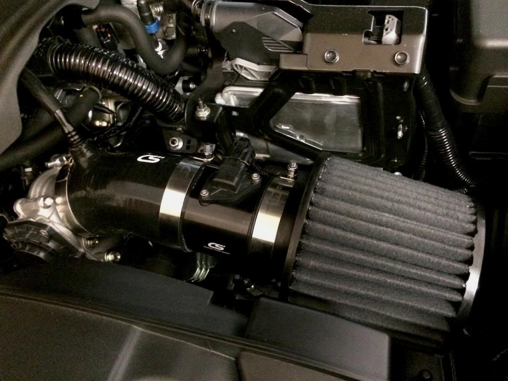

Now to the good part... OEM setup

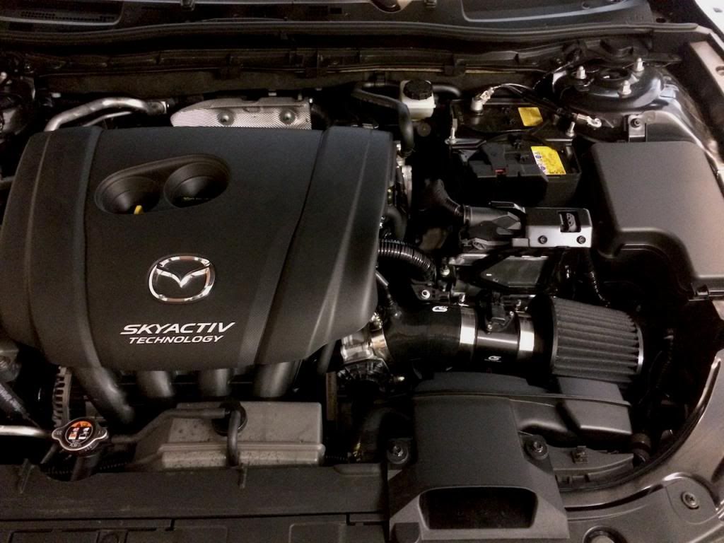

CorkSport SRI. I left the factory air scoop in hopes of it delivering cold air to the intake. The outlet sits below the air filter, so water and stuff that might get in won't directly hit the air filter. CorkSport's instructions say to remove the entire OEM air box but I like thinking outside the box and don't see how leaving the scoop in place would do anything negative. If anything, it will help with cool air.
During my test drive, the SRI along with the CorkSport axle back exhaust is a great combo and the two parts definitely compliment each other and the result is an awesome engine growl and exhaust tone. I definitely recommend these two parts from CorkSport if you're looking to increase performance and sound. Overall the CorkSport intake is a very solid unit and I'm happy with my purchase.

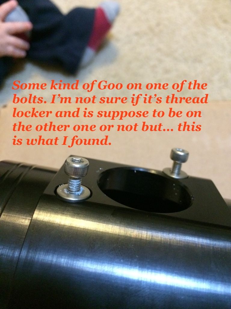

We use loctite on the thread to #1 keep the stainless stand off and #2 prevent any air leaks around the threads. That is what is seen on the first picture as the goo.
The standoff threads inside the MAF housing are on the opposite side and within a cm of being parallel of where the MAF measures air passing so it will not have any effect on airflow. This is something which we had to make a decision on doing two different standoffs or using one. Since the airflow readings were not going to be affected and we did not want to add more cost into the intake we went with 1.
The plastic flashing on the air straightener should have been smoothed off. I will go chat with the operations manager about that. That is the spot where the injection mould puts in the plastic which creates the small bumps sticking up. It doubt it would make a difference but it something that should no go out like that.
When I have trimmed down the t=bolt clamps length I would run them down in place and mark it with a sharpie. Then when you pull them off again you have the exact spot to trim them flush.

That bolt sticking into the housing looks cheap and sloppy and the overly long bolts that you can't put a socket on don't help either.

We use the t-bolt clamps for several application so there will be some extra length unfortunately.
We can change that depth on the standoff screw if you guys want it. I do agree it doesn't look great but it would add more cost to the intake.

A 10mm ratcheting wrench is what I used for my clamps. No problems for me.
261 Posts
Those band clamps are the best option out there. They have thread showing because that's how they are tightened. If the threads were shorter then people would complain about them being to tight.
I don't understand the problem. If you don't like bolts then your only option is those shrink wrap like connections and I'm sure people would screw them up to often.
