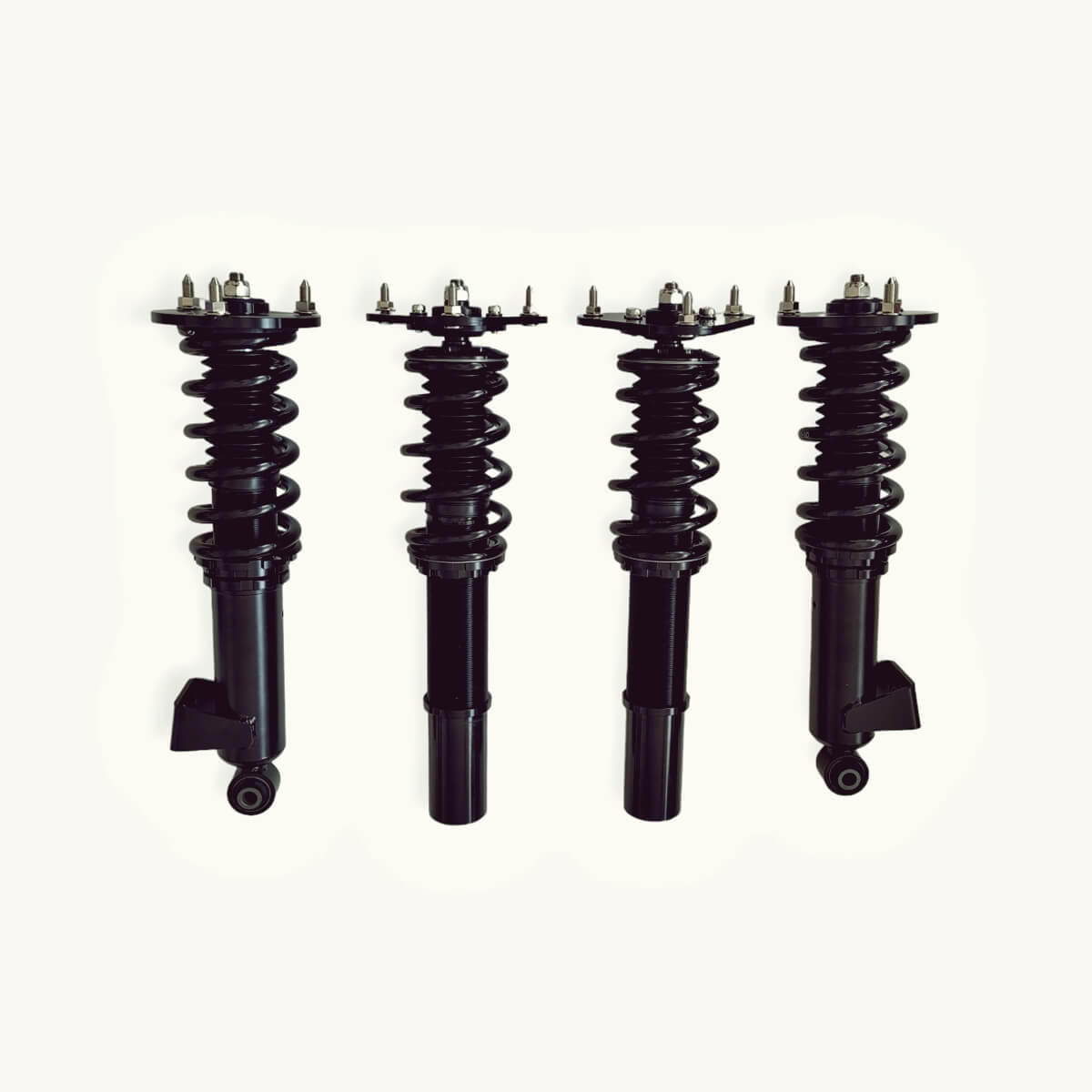

Yeah I found the RSR coilovers on their website. The company's products are reviewed very highly.
The question I have are are they thicker than the OEM struts. I have no clearance at all with my 8.5" +45 Wheels and 235 tires with the OEM struts. I already rub very very rarely during some special cases and some extreme cornering. And have less than 2mm clearance during normal driving conditions.
Also I notice the RSR coilovers are for the 2.0L but it shouldn't make much difference right?
I also like the spring constants 6K in the front and 5K in the back. Your rear sway bar and member brace is going to come handy with this one. Did you see the Ultra Race torsion beam stiffener by the way. It's another stiffness addition still. And the AutoExe motion control beams are excellent. All of them are compatible with each other.
CS coilover spring rates are 5K front and 7K rear.
AutoExe coilover spring rates are, for their street coilovers 3.2K front and 4.7K rear, for their club sports coilovers 10k front and 7k rear
I probably will go the RSR route if its not at all thicker than the OEM or thinner. The BCs are thinner than OEM.

I would suspect most aftermarket shock bodies are thicker than the OEM struts, but hard to say without them in front of me to measure. Your clearance issue is most likely due to your high offset. I'm running 8.5" +38, 225 tires and no issues (I'm pretty confident that I'd be OK on 235's as well).
In my research, all coilovers available for the 3 don't discern over FWD or AWD. I'm a bit worried that I'll get heavier understeer with RSR's front bias spring rate setup, so you're very right that the sway bar/braces will help. Nevertheless I think the rates are in that sweet spot where It'll be a great street setup with a ride that isn't too harsh.
