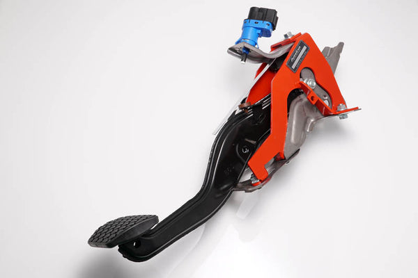

Do you have any plans on installing this piece?
I like the car but I really hate the deep pedal travel of the brakes in this car before they bite. Wondering if something like this would help improve that.
Looked interesting but decided against it since it wouldn't actually increase braking performance. Just a stiffer brake pedal.
