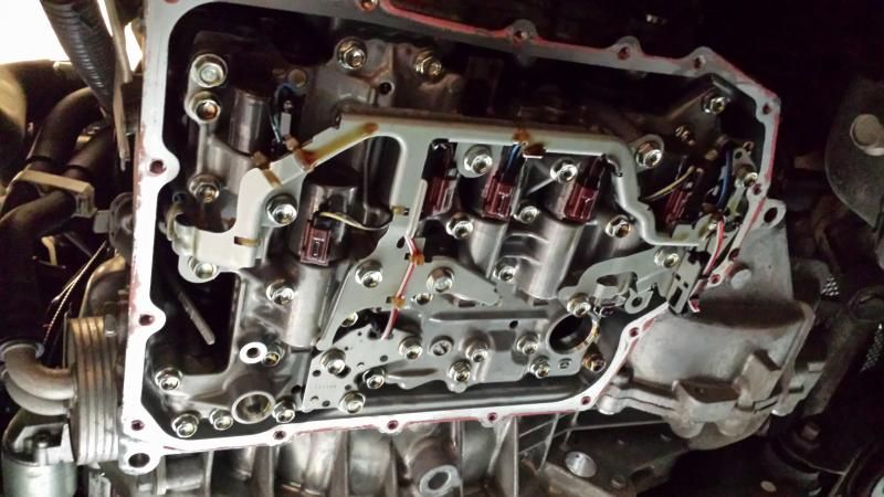

In addition to the above I dropped the pan. This is something that I should not have done being that I did not have a filter to replace the old one and it is alot of work. But, all the rumors surrounding the transmission made me really curious. For the record I am not sure if you can even get a transmission filter as of now but in the future it may be something that is available. The factory uses some sort of red/pink RTV gasket rather than a standard gasket. Initially I thought that it was a standard gasket and that is why I thought it would not be much trouble to drop the pan and have a look.

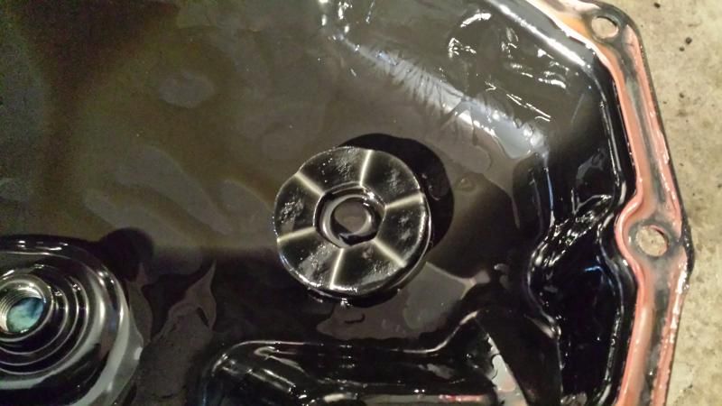

Here is the dirty pan:
The magnet was really not too dirty and there was no sludge - this fluid is super thin like motor oil.

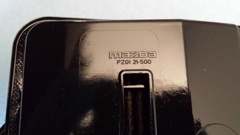

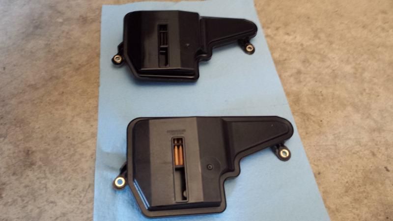

The big black piece here is the filter - it looks kind of like the ones for the older models:
I spent a couple hours cleaning up all of the old gasket on the pan and transmission (it needs to be spotless) So a ~30 min fluid swap became three hours of work and a 24 hour waiting period for the RTV to cure. Hopefully, this helps someone out and saves the headache of wondering - or going overboard and dropping the pan.

If you look at the last picture in the OP there is a shot of the filter. It looks similar to the ones in the older transmissions but I did not check the part number.
